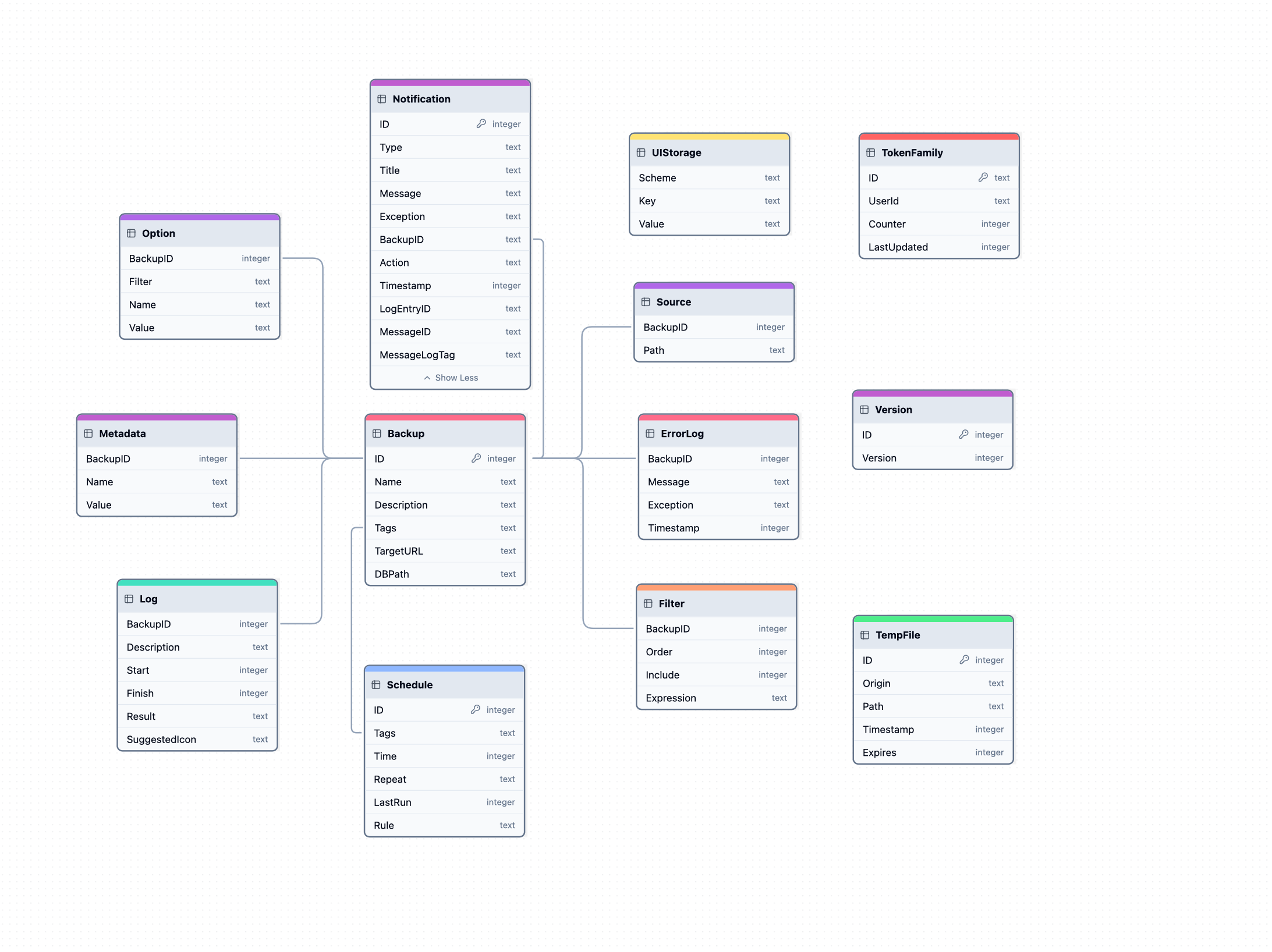

## Server database
<figure><picture><source srcset="https://2363712449-files.gitbook.io/~/files/v0/b/gitbook-x-prod.appspot.com/o/spaces%2F7cMJiGuXy340g9NzpxLY%2Fuploads%2Fgit-blob-f1bf2726723134079d9ea841eea0712981cec7ca%2Fserver-database-3.png?alt=media" media="(prefers-color-scheme: dark)"><img src="https://2363712449-files.gitbook.io/~/files/v0/b/gitbook-x-prod.appspot.com/o/spaces%2F7cMJiGuXy340g9NzpxLY%2Fuploads%2Fgit-blob-168a666cd679fd70810250b87ad8a854aa8cafef%2Fserver-database-4.png?alt=media" alt=""></picture><figcaption><p>Schema overview of the server database</p></figcaption></figure>
The server database was updated in these versions:
Version 5 and less: 2.0.4.23 and earlier
Version 6: Duplicati 2.0.8.1
Version 8: Duplicati 2.1.0.0
Version 9: Duplicati 2.2.0.0
Version 11: Duplicati 2.3.0.0
Version 12: Duplicati 2.4.0.0
Version 13: Duplicati 2.4.1.101 (canary), adds the enabled flag for backups

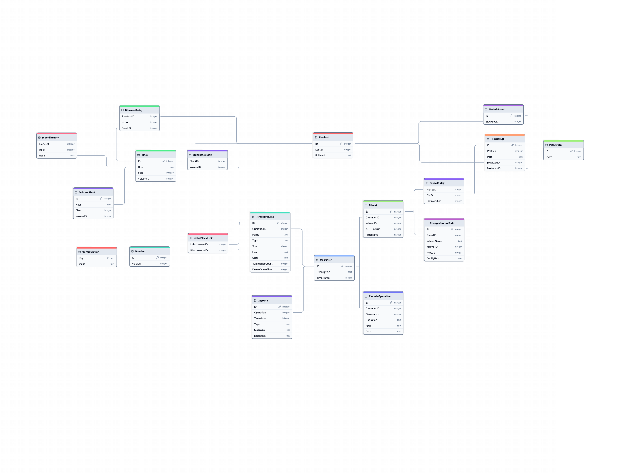

## Local database
<figure><picture><source srcset="https://2363712449-files.gitbook.io/~/files/v0/b/gitbook-x-prod.appspot.com/o/spaces%2F7cMJiGuXy340g9NzpxLY%2Fuploads%2Fgit-blob-80496605a63797e888f1eb96fdac912ccc4a4df8%2Flocal-database.png?alt=media" media="(prefers-color-scheme: dark)"><img src="https://2363712449-files.gitbook.io/~/files/v0/b/gitbook-x-prod.appspot.com/o/spaces%2F7cMJiGuXy340g9NzpxLY%2Fuploads%2Fgit-blob-10571fe67e28fb3c3af0075083e676af47a6e181%2Flocal-database-2.png?alt=media" alt=""></picture><figcaption><p>Schema overview of the local database</p></figcaption></figure>
The local database was updated in these versions:
Version 10: 2.0.5.1
Version 11: 2.0.6.3
Version 12: 2.0.8.1
Version 14: 2.1.0.0
Version 17: 2.2.0.0
Version 19: 2.3.0.0
Version 22: 2.4.1.0
