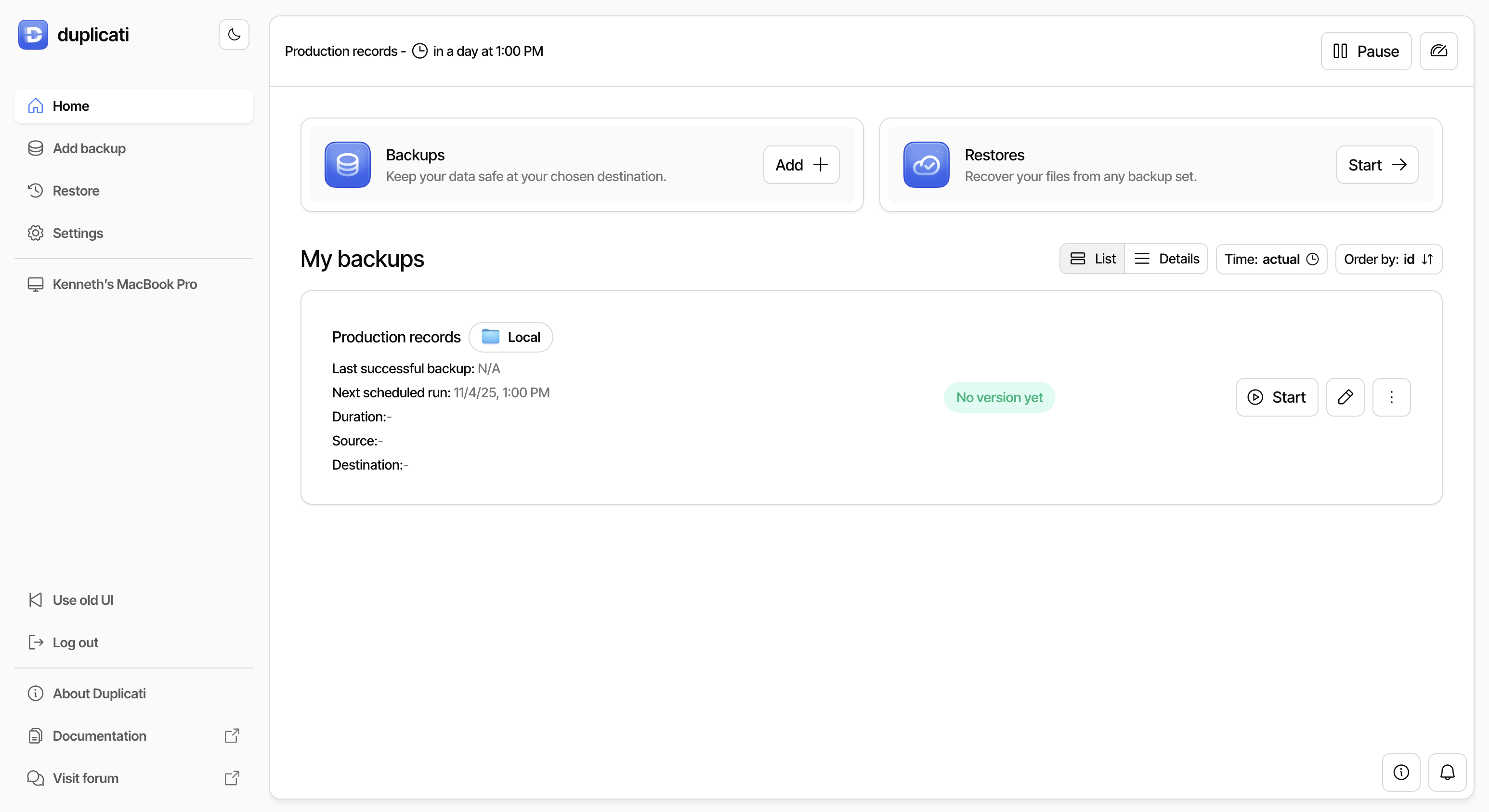

Even if the backup already has a schedule there may be times where you want to manually run a backup. If you have just configured a backup, you may want to run it ahead of the scheduled next run. If you are within the UI you can click the "Start" button for the backup.
<figure><picture><source srcset="https://2363712449-files.gitbook.io/~/files/v0/b/gitbook-x-prod.appspot.com/o/spaces%2F7cMJiGuXy340g9NzpxLY%2Fuploads%2Fgit-blob-55c5421b9477770d63dc5c0db3f772a3aa00475a%2FScreenshot%202025-11-03%20at%2013.35.23.png?alt=media" media="(prefers-color-scheme: dark)"><img src="https://2363712449-files.gitbook.io/~/files/v0/b/gitbook-x-prod.appspot.com/o/spaces%2F7cMJiGuXy340g9NzpxLY%2Fuploads%2Fgit-blob-2aaa13ee7cb555c6722b6f1d85302a694707ddcc%2FScreenshot%202025-11-03%20at%2013.35.31.png?alt=media" alt=""></picture><figcaption><p>A newly configured backup</p></figcaption></figure>
Once the backup is running, the top area will act as a progress bar that shows how the backup progresses. Note that the first run of a backup is the slowest run because it needs to process every file and folder that is part of the source. On later runs it will recognize what parts have changed and only process the new and changed data. If the backup compacts the destination after the backup, the progress of the compact is shown as well, so a long compact no longer looks like the backup has stalled.
If you need to automate starting a backup without using the UI, you can use [ServerUtil](https://docs.duplicati.com/duplicati-programs/command-line-interface-cli-1/serverutil.md) to trigger backups from the commandline.

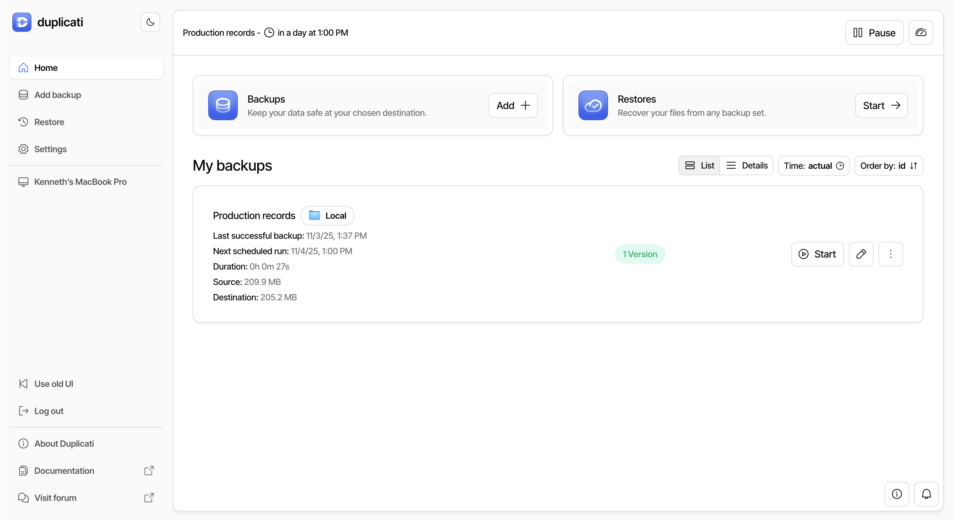

After running a backup, the view will change slightly and show some information about the backup.
