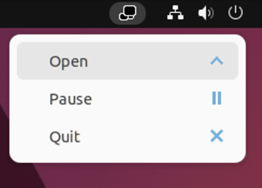

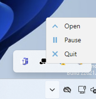

<div><figure><img src="https://2363712449-files.gitbook.io/~/files/v0/b/gitbook-x-prod.appspot.com/o/spaces%2F7cMJiGuXy340g9NzpxLY%2Fuploads%2Fgit-blob-db0e89bff252920b677d1e9251c4d56acf6fc636%2FScreenshot%202024-11-28%20at%2013.44.56.png?alt=media" alt="" width="157"><figcaption><p>TrayIcon on Windows</p></figcaption></figure> <figure><img src="https://2363712449-files.gitbook.io/~/files/v0/b/gitbook-x-prod.appspot.com/o/spaces%2F7cMJiGuXy340g9NzpxLY%2Fuploads%2Fgit-blob-e58bcd31cabf9d2be45224ff252ece0fffad4d65%2FScreenshot%202024-11-28%20at%2013.49.11.png?alt=media" alt="" width="186"><figcaption><p>Status icon on Ubuntu</p></figcaption></figure> <figure><img src="https://2363712449-files.gitbook.io/~/files/v0/b/gitbook-x-prod.appspot.com/o/spaces%2F7cMJiGuXy340g9NzpxLY%2Fuploads%2Fgit-blob-aa782bb9eab9f2864d7cb6034ed8d04d8fdbc78a%2FScreenshot%202024-11-28%20at%2012.18.52.png?alt=media" alt="" width="129"><figcaption><p>Statusbar icon on MacOS</p></figcaption></figure></div>
