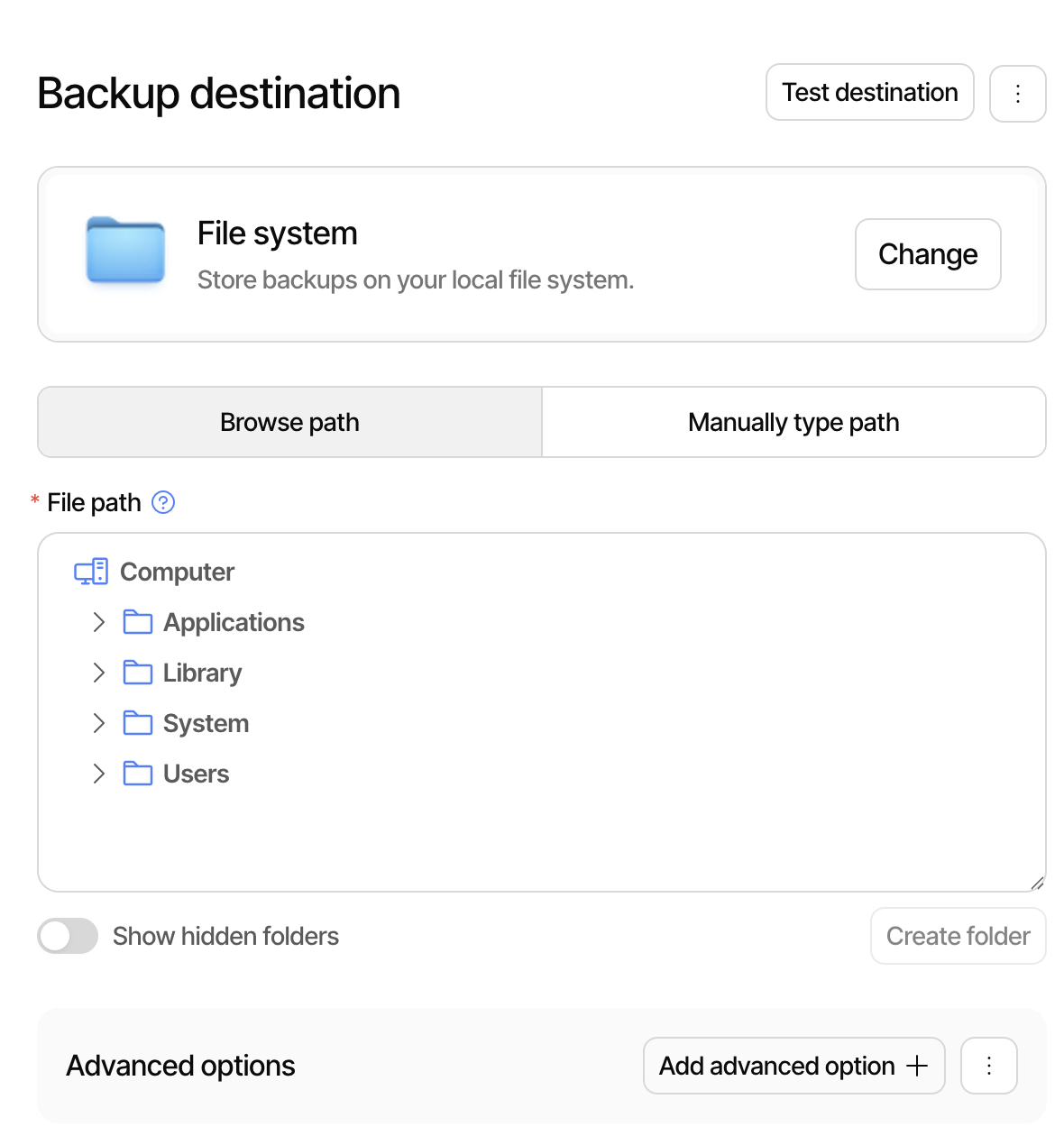

In the user interface you simply need to either pick or type the path to where the backup data will be stored.
The file-based storage destination configuration view
