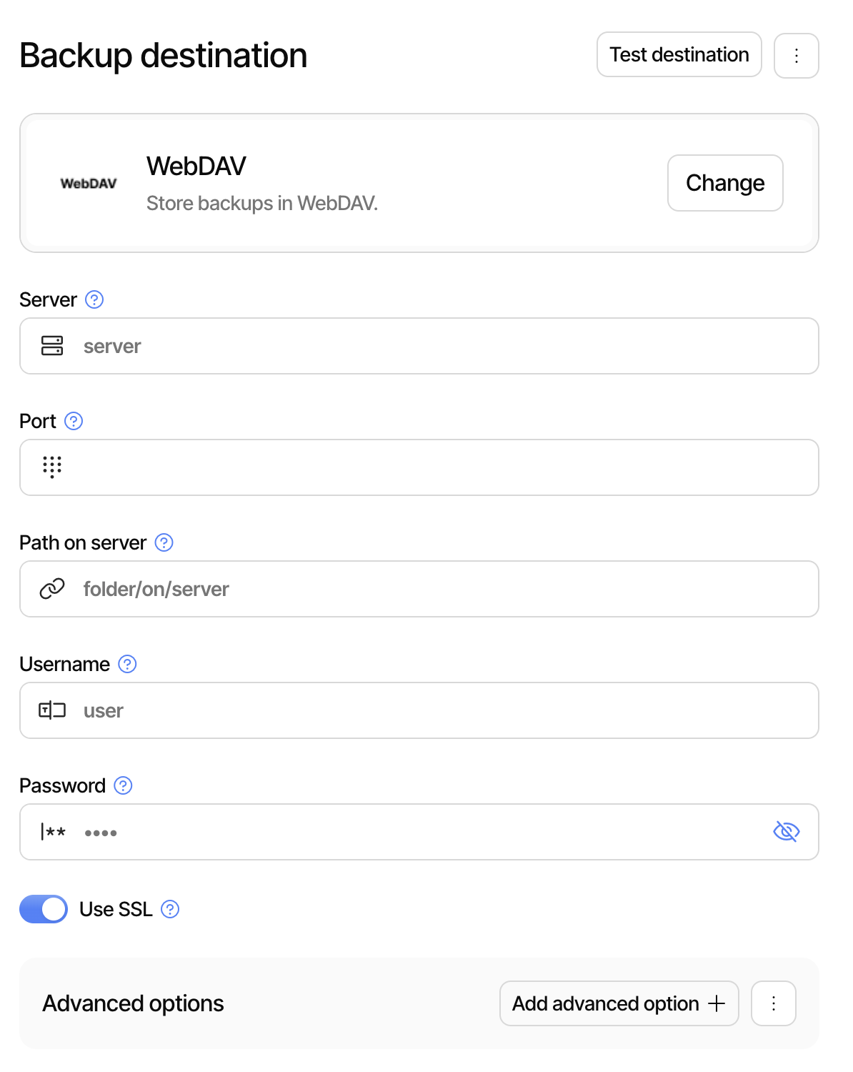

<figure><picture><source srcset="https://2363712449-files.gitbook.io/~/files/v0/b/gitbook-x-prod.appspot.com/o/spaces%2F7cMJiGuXy340g9NzpxLY%2Fuploads%2Fgit-blob-d634be88a3ea3025df271e113f315cab55e9029a%2FScreenshot%202025-11-03%20at%2014.55.28.png?alt=media" media="(prefers-color-scheme: dark)"><img src="https://2363712449-files.gitbook.io/~/files/v0/b/gitbook-x-prod.appspot.com/o/spaces%2F7cMJiGuXy340g9NzpxLY%2Fuploads%2Fgit-blob-d427653d3a2af272f7694e79eea402198faaac86%2FScreenshot%202025-11-03%20at%2014.55.21.png?alt=media" alt="Showing the options needed for configuring the WebDAV connection"></picture><figcaption></figcaption></figure>
To use the WebDAV destination you must enter: server, path on server, username and password. Depending on your setup, you may also need to add some advanced options as explained below.
