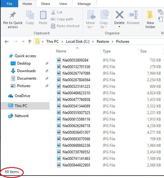

Restoring files using the Recovery Toolarrow-up-right
After all backup files are downloaded, decrypted and indexed, you can start with the actual restore process. With the Duplicati Recovery Tool, use therestore command to restore all files that can be recovered from any backup version to the location of your choice:
Duplicati.RecoveryTool.exe restore <localfolder> [version] [options]
<localfolder> is a required option. It should point to the location where your downloaded remote files are stored. Optionally add --targetpath to specify where files must be restored to, otherwise the files are restored to their original locations. Use filters or the --exclude option to perform a partial restore. See excludearrow-up-right and APPENDIX D Filtersarrow-up-right for more information.
In this example, files are restored to C:\Restore, so an empty folder C:\Restore is created first.
This command will restore all files from the latest backup version (0) to C:\Restore:
Duplicati.CommandLine.RecoveryTool.exe restore C:\BackendFiles 0 --targetpath="C:\Restore"
The output starts with something similar to this:
All restored files are listed. The list probably contains errors, because files that need data from corrupted blocks cannot be restored.
In this example, from a corrupted backup with one deleted dblock file and one corrupted dblock file, 69 of 75 picture files were recovered successfully.
