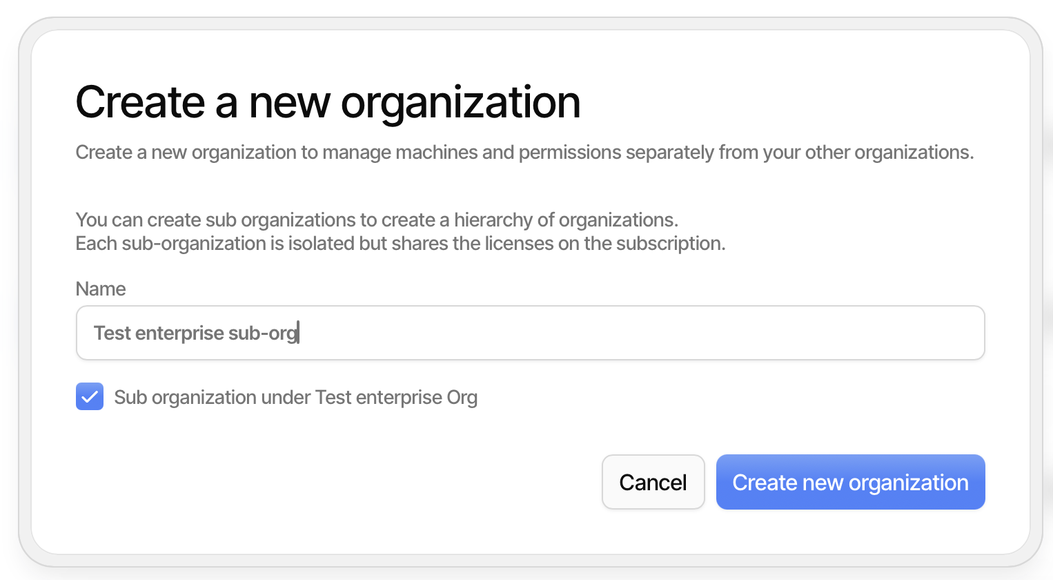

3. **Name and confirm**: Provide the customer name and confirm creation. The console records the parent/root identifiers automatically and returns you to the organization list. The screen for creating an organization looks like this:
<figure><picture><source srcset="https://2363712449-files.gitbook.io/~/files/v0/b/gitbook-x-prod.appspot.com/o/spaces%2F7cMJiGuXy340g9NzpxLY%2Fuploads%2Fgit-blob-8200a24e34d4ff419ae091806d5be53026d63d64%2FScreenshot%202025-12-02%20at%2011.33.03.png?alt=media" media="(prefers-color-scheme: dark)"><img src="https://2363712449-files.gitbook.io/~/files/v0/b/gitbook-x-prod.appspot.com/o/spaces%2F7cMJiGuXy340g9NzpxLY%2Fuploads%2Fgit-blob-3a1c369313afc6804d488a886e274dbe1f818c5e%2FScreenshot%202025-12-02%20at%2011.32.45.png?alt=media" alt="Image showing the create organization dialog"></picture><figcaption></figcaption></figure>

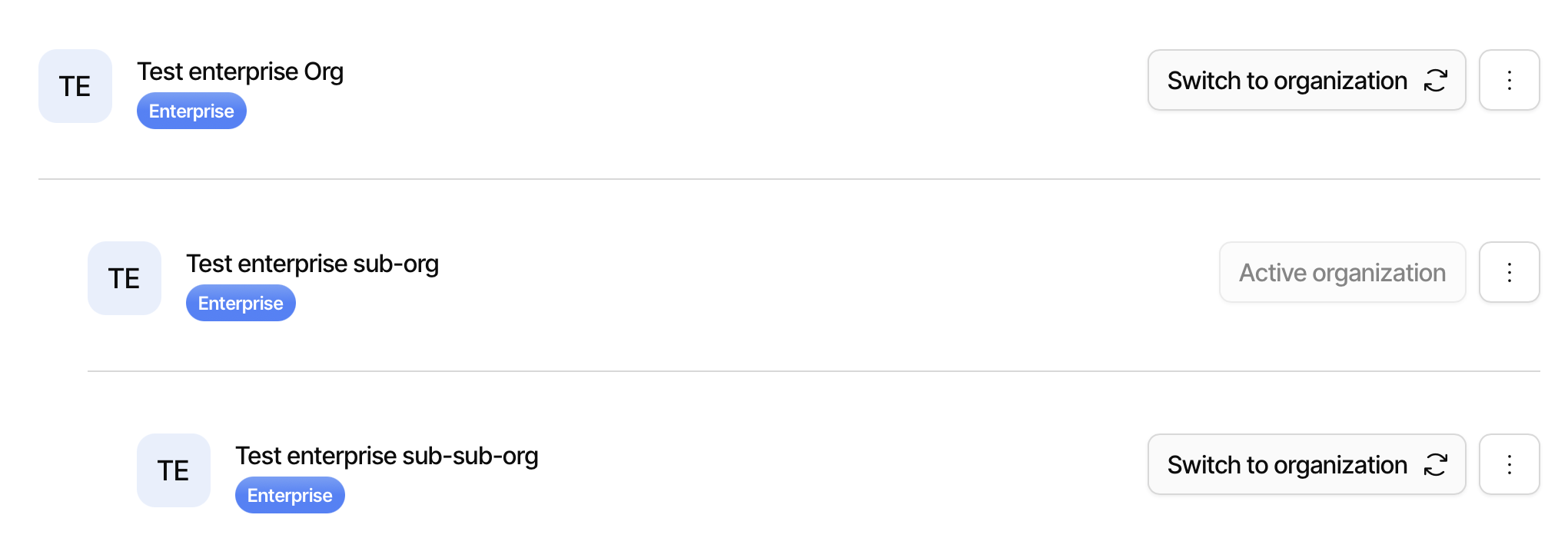

An example setup for a multi-level enterprise organization could look like this:
<figure><picture><source srcset="https://2363712449-files.gitbook.io/~/files/v0/b/gitbook-x-prod.appspot.com/o/spaces%2F7cMJiGuXy340g9NzpxLY%2Fuploads%2Fgit-blob-0d37adb8df27ed5eda8b2af25ed09f8d53cf4a97%2FScreenshot%202025-12-02%20at%2014.15.33.png?alt=media" media="(prefers-color-scheme: dark)"><img src="https://2363712449-files.gitbook.io/~/files/v0/b/gitbook-x-prod.appspot.com/o/spaces%2F7cMJiGuXy340g9NzpxLY%2Fuploads%2Fgit-blob-4af440dfc745ff4911a3e102a44aee9223f0cbb1%2FScreenshot%202025-12-02%20at%2014.15.44.png?alt=media" alt="Image showing an example 3-level organization structure"></picture><figcaption></figcaption></figure>
