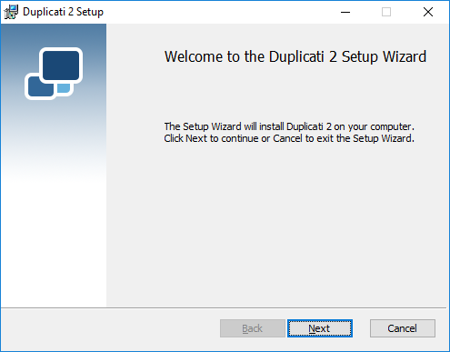

First step is the Welcome screen. Click Next to proceed.

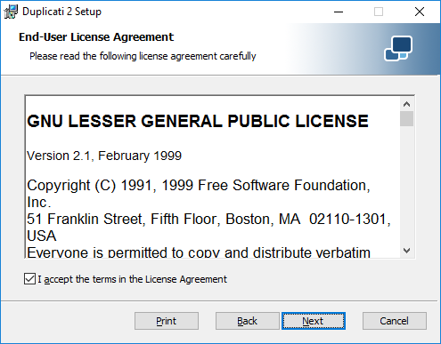

Read the license agreement. If you agree, select I accept the terms in the License Agreement and click Next.

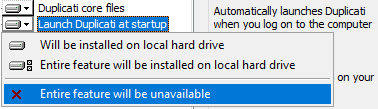

Select which components you want to install. Pay special attention to Launch Duplicati at startup. If it is selected, the Duplicati Tray Icon Tool will be started automatically after logging on to Windows. The Duplicati Server component is included in the Tray Icon tool. If you want to start the server component another way (i.e. by registering the server component as a Windows service), you have 2 options:
  • Disable Launch Duplicati at startup.
The Tray Icon tool will be installed, but not automatically started. You can start it manually by executing Duplicati.GUI.TrayIcon.exe.
  • Keep Launch Duplicati at startup enabled, but modify the properties of the shortcut after the installation wizard has been completed.
This will ease access to the Duplicati Web interface, but if you don't manually deactivate the internal server component, you will end up with multiple Duplicati instances, which is probably undesirable.

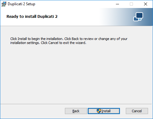

Click the Install button to start the installation.

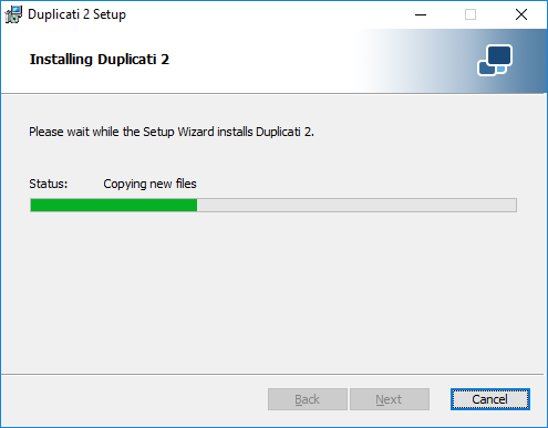

Wait for the installation procedure to complete.

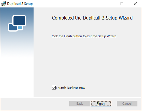

If you don't want to start the Duplicati Tray Icon tool now (i.e. if you want to register it as a service), deselect Launch Duplicati now.
Click Finish to complete the installation wizard.

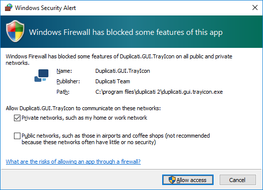

The first time the server component starts, Windows Firewall (or another third party firewall application) may show an alert. Allow Duplicati to communicate over the network.
